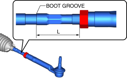

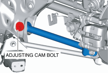

  • Hier gibt es die Mazda-Vorgaben aka "Wurftoleranzen":
    Vorderachse:
    FRONT WHEEL ALIGNMENT | 2016 ND Shop Manual
    < Previous Next > Specification (Unloaded Condition) NOTE: 1. Loosen the tie-rod end locknuts. 2. Remove the steering gear boot clamp. 3. Rotate the tie rod…

    Hinterachse:
    REAR WHEEL ALIGNMENT | 2016 ND Shop Manual
    < Previous Next > Specification (Unloaded Condition) NOTE: 1. Loosen the installation nut of the lower link adjusting cam bolt. 2. Rotate the adjusting cam…
